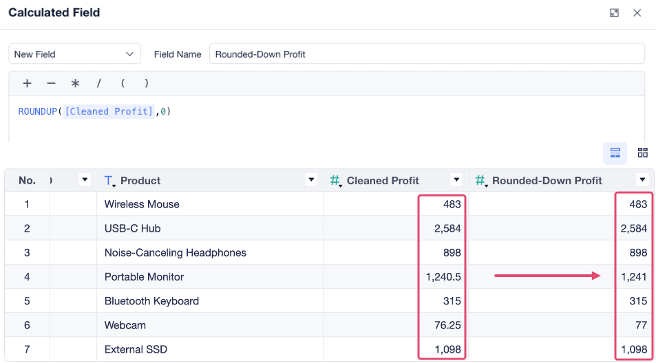

More Examples
For example, you can use ROUNDUP to remove the decimal part of Cleaned Profit and round the value up to an integer.
