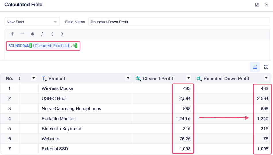

More Examples
For example, you can use ROUNDDOWN to remove the decimal part of Cleaned Profit and round the value down to an integer.
